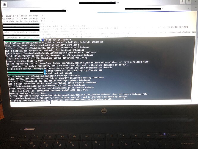

So I finally started installing Zigbee2MQTT via the link you provided. I was able to complete step 1 (Find the Zigbee-Adapter)
but at step 2 I realized that I need to install Docker. So for the last couple hours I've been researching docker (no Docker-Compose) and trying to install it.
Lots of errors which I've been trying to resolve along the way with minimal success. Will try to post to the debian forum tomorrow but just thought I'd share an update. Many thanks!
Just to say, you do NOT require Docker for zigbee2MQTT
You probably want this section of the instructions Linux | Zigbee2MQTT
