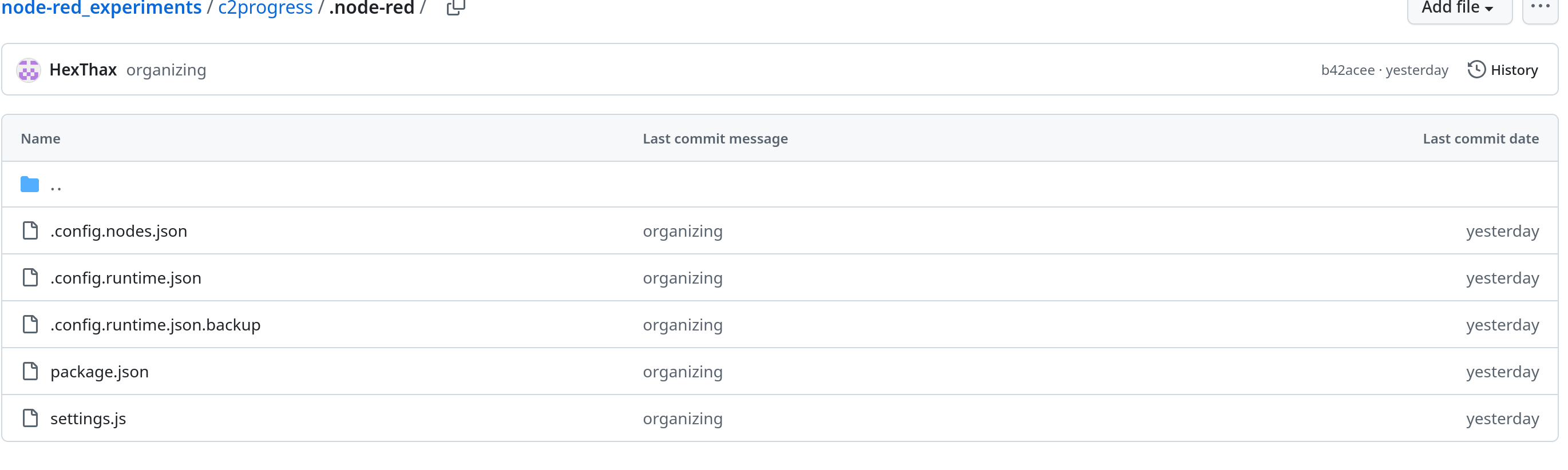

The flow is checked in here, node-red_experiments/c2progress/.node-red at main · hdlguy/node-red_experiments · GitHub, but it is a hidden folder so sometimes I also miss seeing it.

The flow is not in that directory

@jbudd I'm not interested in the C code, I have that, I want to see the Node-RED flow so I can actually see how the exec node is configured (e.g. is the full path to the executable provided)
OK, thanks again for the attention to my problem. I have now committed flows.json to the repo. I also got the got the flow to run with the exec node in spawn mode. The trick was to use an absolute path to the compiled C command.
