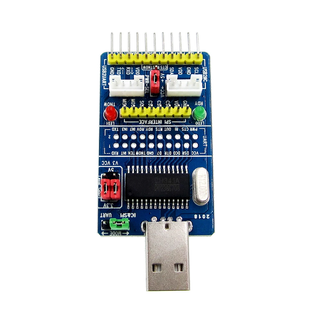

I used the Atlas Scientific PH print and en UART device from Ali.
This works with the flow I already found!
I used the UART part of the CH341A print
Check this out.
