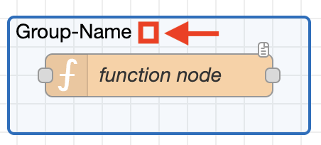

  1. Also display this little icon if a group has a description (maybe behind the Group Name):

  1. The reason this isn't yet possible for groups is that it's still experimental; the team is waiting for feedback. Putting the icon as you suggest is not visible enough, I would keep the same place as on the node.

I think that for a group it would best be displayed at the top right corner of the group, similar to how it is on a node, only inside the group outline.

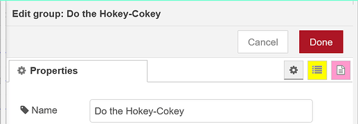

Would it be useful to apply a class to the Description button if there is a description for the group or node, so that the button can be highlighted via CSS? (For groups/tabs, the Environment Variables button too)
