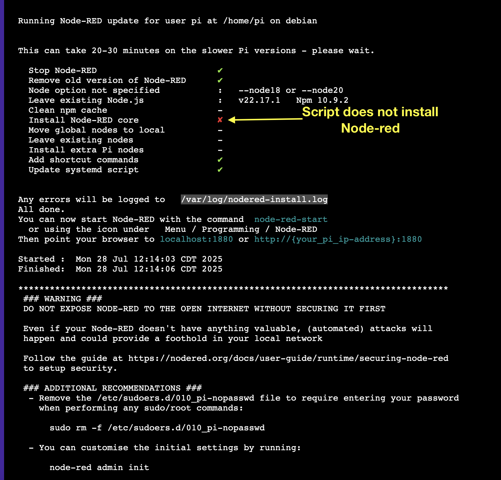

I'm trying to install Node-RED on a RPi5 alongside the prebuilt Homebridge image. Has anyone installed this successfully? If so, any pointers/guidance would be really appreciated.
When I install using the RPi script, it shows that Node-RED core was not installed

But when I try and run it as a service using node-red-start, it errors out with the following output
pi@homebridge:/var/lib/homebridge $ node-red-start
Start Node-RED
Once Node-RED has started, point a browser at http://192.168.1.170:1880
On Pi Node-RED works better with the Firefox or Chrome browser
Use   node-red-stop                          to stop Node-RED
Use   node-red-start                         to start Node-RED again
Use   node-red-log                           to view the recent log output
Use   sudo systemctl enable nodered.service  to autostart Node-RED at every boot
Use   sudo systemctl disable nodered.service to disable autostart on boot
To find more nodes and example flows - go to http://flows.nodered.org
Starting as a systemd service.
nodered.service: Failed with result 'exit-code'.
node-red-start
nodered.service: Scheduled restart job, restart counter is at 51.
Stopped nodered.service - Node-RED graphical event wiring tool.
Started nodered.service - Node-RED graphical event wiring tool.
/usr/bin/env: ‘node-red-pi’: No such file or directory
nodered.service: Main process exited, code=exited, status=127/n/a
^Cpi@homebridge:/var/lib/homebridge $
I have also tried to install using NPM ( sudo npm install -g --unsafe-perm node-red) but that ends with sudo: npm: command not found
