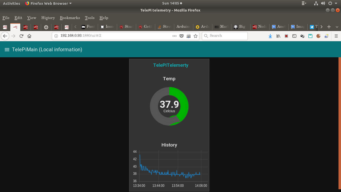

I have a gauge set as a doughnut.
This is happening now and then with certain values.
Notice how the green is ..... deformed at the end of the end of the arc.

Ok, this is the code.
Just checked again and it is REAL TIME and happening (again) now.
[{"id":"eee1874.73656f8","type":"inject","z":"9b7e7466.a4b698","name":"Timer","topic":"","payload":"","payloadType":"date","repeat":"10","crontab":"","once":true,"x":100,"y":80,"wires":[["8f8cb716.58088","4044a197.41b5a8"]]},{"id":"8f8cb716.58088","type":"exec","z":"9b7e7466.a4b698","command":"/opt/vc/bin/vcgencmd measure_temp| sed 's/[^0-9]*//g'","addpay":false,"append":"","useSpawn":"false","timer":"","oldrc":false,"name":"Check Temp","x":250,"y":80,"wires":[["3a4ae1d4.820cce"],[],[]]},{"id":"3a4ae1d4.820cce","type":"function","z":"9b7e7466.a4b698","name":"Make number and set Topic","func":"msg.payload = Number(msg.payload)/10;\nmsg.topic=global.get('myDeviceName');\nmsg.topic =\"TEMP/\" + msg.topic;\nreturn msg;\n","outputs":1,"noerr":0,"x":480,"y":80,"wires":[["5e188813.e8edd","6cdb7a0f.bfd02c","19cb42a6.97bbb5","a6924ea0.caa7e"]]},{"id":"6cdb7a0f.bfd02c","type":"ui_gauge","z":"9b7e7466.a4b698","name":"","group":"b91547a3.789ea","order":1,"width":0,"height":0,"gtype":"donut","title":"Temp","label":"Celcius","format":"{{value}}","min":"10","max":"80","colors":["#00b500","#e6e600","#ca3838"],"seg1":"56","seg2":"60","x":710,"y":120,"wires":[]},{"id":"b91547a3.789ea","type":"ui_group","z":"9b7e7466.a4b698","name":"TelePiTelemerty","tab":"6173326e.e27724","order":1,"disp":true,"width":"6"},{"id":"6173326e.e27724","type":"ui_tab","z":"9b7e7466.a4b698","name":"TelePiMain (Local information)","icon":"dashboard","order":5}]
Basically I am sending temperature values to the gauge.
If it is around 37.9 it give this error.

It starts at 35.4 and ends at about 42.6 as far as I can see.
I put an slider node and set the range from 0 to 800 with a step of 1.
So on the slider at about 354 - 426 it happens.
