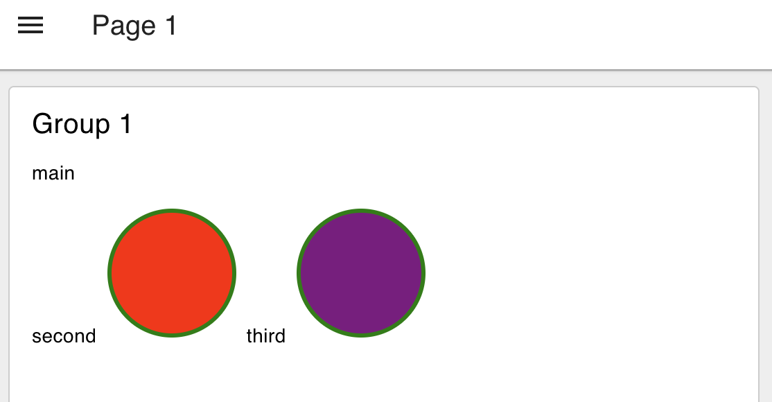

I asked about something similar, someone suggested teleports but I haven't tested them yet
I think it works
        "id": "d6a3e0b6ab0e388e",
        "type": "ui-template",
        "z": "19cb94d5b096ef08",
        "group": "cd0dac1475062196",
        "page": "",
        "ui": "",
        "name": "main",
        "order": 1,
        "width": 0,
        "height": 0,
        "head": "",
        "format": "<template>\n     main\n  <div id=\"aaqu-target\"></div>\n</template>",
        "storeOutMessages": true,
        "passthru": true,
        "resendOnRefresh": true,
        "templateScope": "local",
        "className": "",
        "x": 230,
        "y": 600,
        "id": "bbe97f8f97bd2b88",
        "page": "",
        "ui": "",
        "name": "second",
        "order": 2,
        "width": 0,
        "height": 0,
        "head": "",
        "format": "<template>\n\n  <Teleport v-if=\"mounted\" to=\"#aaqu-target\">\n      second\n      <svg height=\"100\" width=\"100\" xmlns=\"http://www.w3.org/2000/svg\">\n        <circle r=\"45\" cx=\"50\" cy=\"50\" stroke=\"green\" stroke-width=\"3\" fill=\"red\" />\n      </svg>\n  </Teleport>\n\n</template>\n\n<script>\nexport default {\n  data(){ \n    return { mounted: false }\n  },\n  mounted(){ this.mounted = true },\n}\n</script>\n",
        "passthru": true,
        "className": "",
        "x": 240,
        "y": 660,
        "id": "35729a1f8963daed",
        "page": "",
        "ui": "",
        "name": "second",
        "order": 3,
        "width": 0,
        "height": 0,
        "head": "",
        "format": "<template>\n\n  <Teleport v-if=\"mounted\" to=\"#aaqu-target\">\n      third\n      <svg height=\"100\" width=\"100\" xmlns=\"http://www.w3.org/2000/svg\">\n        <circle r=\"45\" cx=\"50\" cy=\"50\" stroke=\"green\" stroke-width=\"3\" fill=\"purple\" />\n      </svg>\n  </Teleport>\n\n</template>\n\n<script>\nexport default {\n  data(){ \n    return { mounted: false }\n  },\n  mounted(){ this.mounted = true },\n}\n</script>\n",
        "passthru": true,
        "className": "",
        "x": 240,
        "y": 700,
        "id": "cd0dac1475062196",
        "type": "ui-group",
        "name": "Group 1",
        "page": "e188ea992f7b5998",
        "width": 6,
        "height": 1,
        "order": 1,
        "showTitle": true,
        "className": "",
        "visible": true,
        "disabled": false,
        "groupType": "default"
