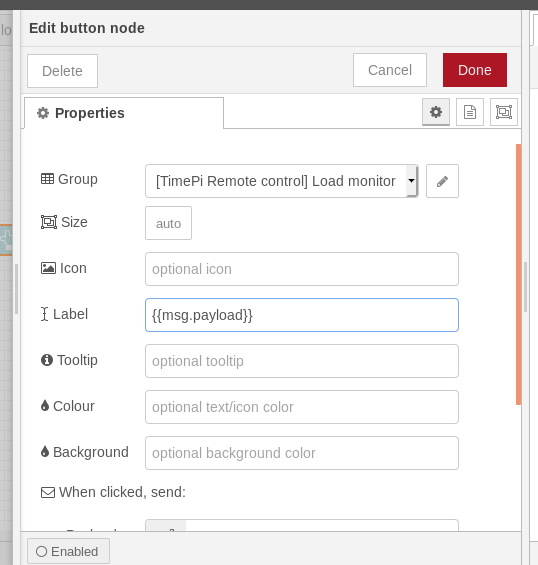

I think - and I have been told that is dangerous - you want to display text which is arriving from form. Correct?
Then you need to open the button's configuration and put something like this:
In this example the text display is in msg.payload.
That is the default.
But you can change that to just about anything you want.
Does that help?
