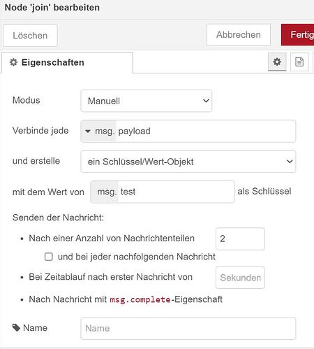

What is may mistake?
If it helps I can easily sen the export file.
Thanks
MAYBE because you are telling it to create a key/value object when you are sending it JSON messages.
I'm not sure.
But to me there is something going on there.
You have told it to use msg.test to identify the different message types to join, but one of your messages does not have msg.test set.
