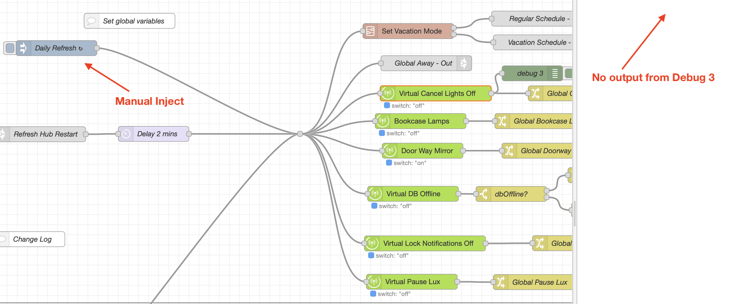

I recently started using the junction feature in NR editor and I’m seeing some inconsistent results. In some cases, the logic is not getting triggered for some of the wires. In the example below, the flow never goes through the “Virtual Cancel Lights Off” node and hence the setting of the global variable in the connected node does not happen (you can see there is no output from the debug node directly connected to the “Virtual Cancel Lights Off” after I clicked the “Daily Refresh” inject node.
However, if I directly connect an inject node into the “Virtual Cancel Lights Off” node, I can trigger the output.
Is there a known issue with “junction” wires? Is there an alternative way to achieve the same objective (visual and logic)? I think I previously had wires connect directly and it was a mess :frowning:

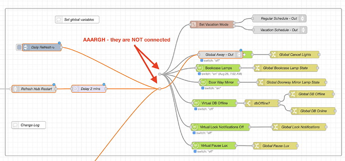

Shift+click on the Mac? Half my “connected” wires are not selected (the orange wires are selected, others not). I have removed and reconnected the one node that I was testing earlier and it made no difference.
Wow, that is a good catch.

There are options to select all downstream nodes and all connected nodes. On my PC they are alt-s d and alt-s c, may be different on a mac. They should be on the show action list dropdown.
I guess alt-s c when the junction is selected is the one to go for.
Now that is a good catch - they “look” like they are connected but are not actually connected☹️

I think that arguably there is a bug there. If two normal nodes overlap then they show a warning exclamation mark. That does not happen with junctions. I think it should.
