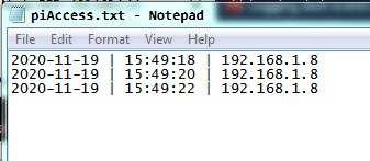

JOIN (manual, join using \n) combines the two and FILE (append, \n) writes it. I can't get a new line without a \r, and have tried seemingly every combo of where and how to place the (multiple) \n's required to make this work? Though some appear to be doing nothing, omitting then is worse.
Right now, the date with tab is first, then the IP and new line. Assuming I add other items, how does one control the order these items appear in?
Image 002
Hopefully someone can provide insight on where I can better learn how to structure multiple items into a "line"?

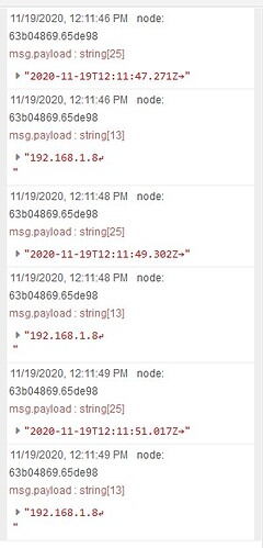

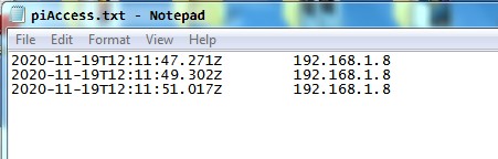

Much nicer, thanks! I tried your function node as-is with only "new line"checked in file, no new line. Tried adding \n to your function, no new line. Tried \r appended to your (modified) function, then removing "new line" from file, no new line. So, I actually need the "new line check" in file, but also need a \r in the function. Without both, no new line. Works, but not as expected.
Image 004
I'm studying on how to build a string from various N-R sources. If I import payloads from different nodes into one function, are those sortable using variables?
Thanks!
Russ
