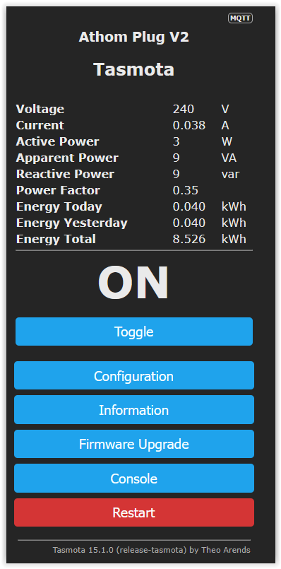

I use these mains plugs flashed,with Tasmota, to talk to/from Node-RED using MQTT.
https://www.aliexpress.com/item/1005008584169841.html
They report usage-data... V, A, W, kWh, power factor.

Once upon a time you could get almost any brand and flash Tasmota without opening up the case but no longer.
There are are a couple of brands that come pre-flashed: Localbytes in the UK and Athom elsewhere. I guess the iotorero plugs are Athom by another name.
I personally will not buy from Athom because a batch were delivered to the wrong address and stolen. Athom would not take responsibility, despite Evri taking a photo of the package on someone else's doormat.
Don't believe the assertion "The IoTorero plug arrives pre-flashed and pre-assembled, requiring no calibration for immediate use.". You definitely need to calibrate the power monitoring feature.

i have found all of the ESP32 ones with the additional chip seem to be well calibrated (against known power draws here)
The older ones based on the ESP8285 which did not have the seperate power chip did indeed require calibration.
Are you using the ESP32 ones or the ESP8285 ?
Craig
Sorry, don't know.
It's true that when I bought some more sockets recently, their calibration was way further out than the original ones. eg it claimed to see 320V.
