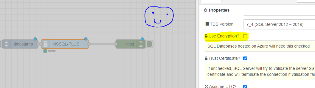

On the non working W10 machine, did you check and toggle "Trust Certificate" in the connection settings?
There was a recent change in underling tedious sql code that forces the default to NOT trust.
TEST 1...
can you try toggle that new setting, deploy, test, toggle back, deploy, test.

@Steve-Mcl ,so much so that the solution is a simple click.
If I needed to connect to azure I could not, but to the local database I can
@Nxito I should have asked - I assumed you wanted to use encryption (otherwise I would have told you so check that) DOH!
