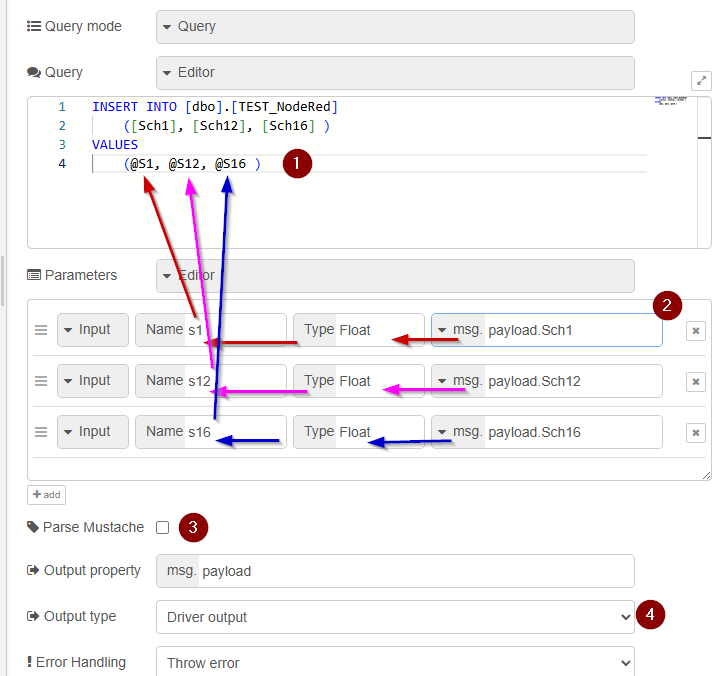

Dont use mustache. It is slower, can lead to syntax issues in the final query (especially if values are strings) and in the worst case can open the door to SQL injection hacks.
Use the built in parameter mapping.
  1. use @named parameters
  2. map from msg (or whatever) to as type and named parameter
  3. disable mustache
  4. use driver output
