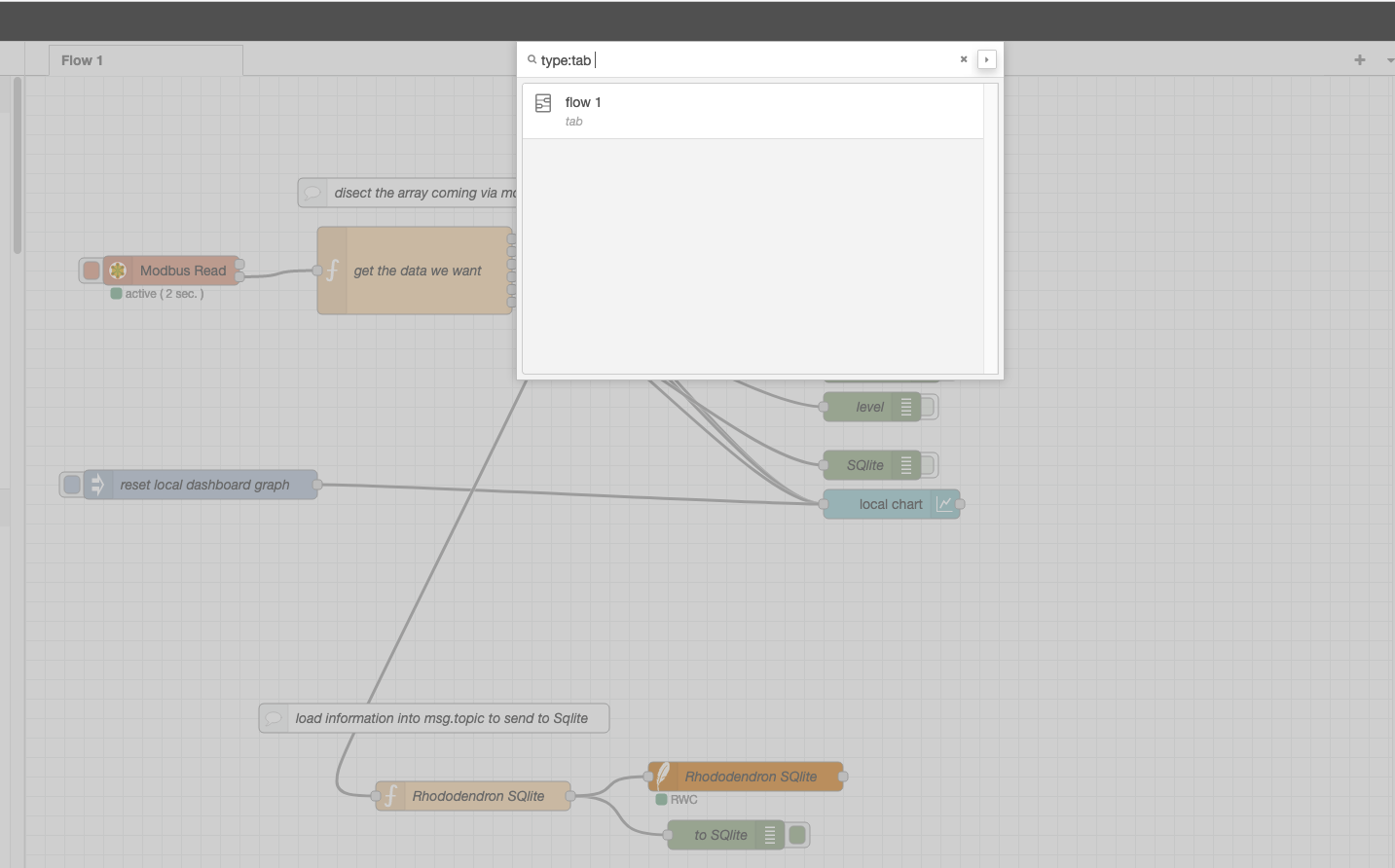

What do you see if you Search (from menu or Ctrl-F) for ubidots.
If nothing then stop node-red and start it again in a terminal. Post the full console output here, including the errors you are seeing which should appear there.
Hi Colin,
This is what I get with a general search. It shows the Ubidots icon but nothing happens when I click or doubleclick on it.

I'm not sure why there is a difference since I can only see one flow but its seems like the all flows has more information.
I have searched and can't find anything about "ubidot" in either of these files.
Sorry, my node red server is running in a proxmox VM at the moment, and I can't copy/paste from that terminal. I should have ssh'ed for you.
Try clearing the cache in your browser (using the menus) then refresh the node-red page and try again. Alternatively try a different browser or connect from a different computer.
that did it!
Thanks.
(You may want to mark the post that showed you the solution as the solution.
That way others can use it for help if they are stuck with a similar problem.)
