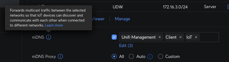

In Unifi, you select which networks, can see each others broadcasts.
Without knowing OMADA - maybe try and find an area that manages this?
