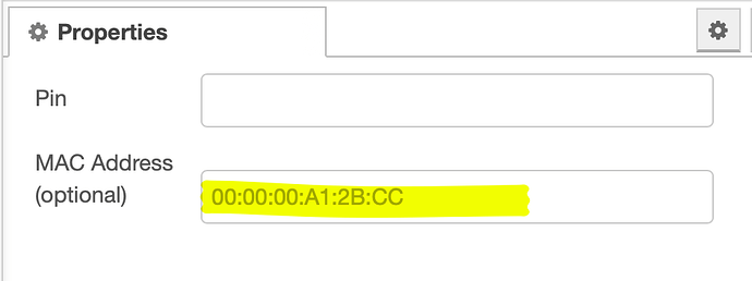

Which node are you referring to ?
Changing a pin may not be enough (did you restart node-red ?). Homebridge uses mdns to communicate (i believe) and that is reachable via a mac address
Example; this is from the node-red-contrib-homebridge-automation node:
Yeah, I set the new MAC address into all the HB nodes I use. Maybe I missed one?
Everything is working now. I had to restart the node red service. Duh. Thanks for your help.
