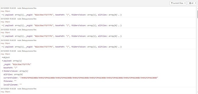

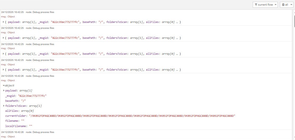

The Error:
When the recursive flow runs, my debug sidebar shows that the currentFolder variable is being corrupted. It continuously appends the same folder name to itself instead of moving down to the next date-stamped subfolder:
currentFolder: "/9K092FDPAGC88BD/9K092FDPAGC88BD/9K092FDPAGC88BD/...".
Because of this, the foldersToScan array never empties, and the flow never reaches the actual image files located at the bottom of the tree.
The Question
How can I modify my function node to correctly identify subfolders and build the path without this self-referencing recursion?

here are both my flow and the errors .
the code of the function process files and folders:
