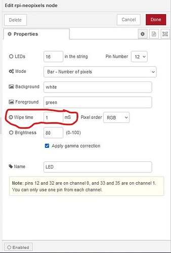

You generate the Comma Separated Value by setting payload to (for example) 0,299,0,0,255 but as you said it didnt work.
If you want me to check your flow, export it to a reply.
Don't know if you got a fix but what work for me is to change the wipe time to 1, (0 made the dashboard not load).
Ok thanks didnt look in a time but it works with Wipe time 0 as well because i dosnt use the dasbord but for me the dashboard loads dont know if this is a problem.
