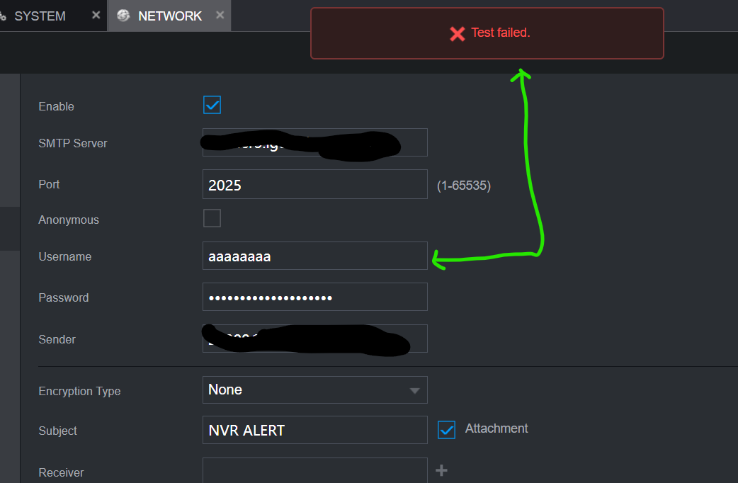

  1. DVR setup with no username, works, and I see it in Node-red.
  2. DVR setup with username, fails (and I get no message in Node-red):
Not sure really - I have tried locally with both Node-RED sending the mail and a local Thunderbird client - and both work ok. To me they look like client errors that are reporting back that the server doesn't support authentication - which is indeed how you have set it up... so why would you want the server to mislead you ?
Not mislead. If no authentication is selected I would assume it would ignore credentials rather than reject.
No problem though, I'll work with it, thanks for the help.
Not sure why it actually rejects as all tests I have done still seem to deliver the mail. Maybe the client is refusing to send if it sees no handshake.
