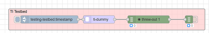

I've actually created a test node that is an inline debug, threw-out:
Sorry for the pun-ish naming. :slight_smile: The icon indicates whether output is on or off.
Really doesn't matter, useful discussion points anyway, thanks for sharing.
@dimitrieh, happy to discuss whether that test node should be fed back into the current debug node or become a contributed node.
