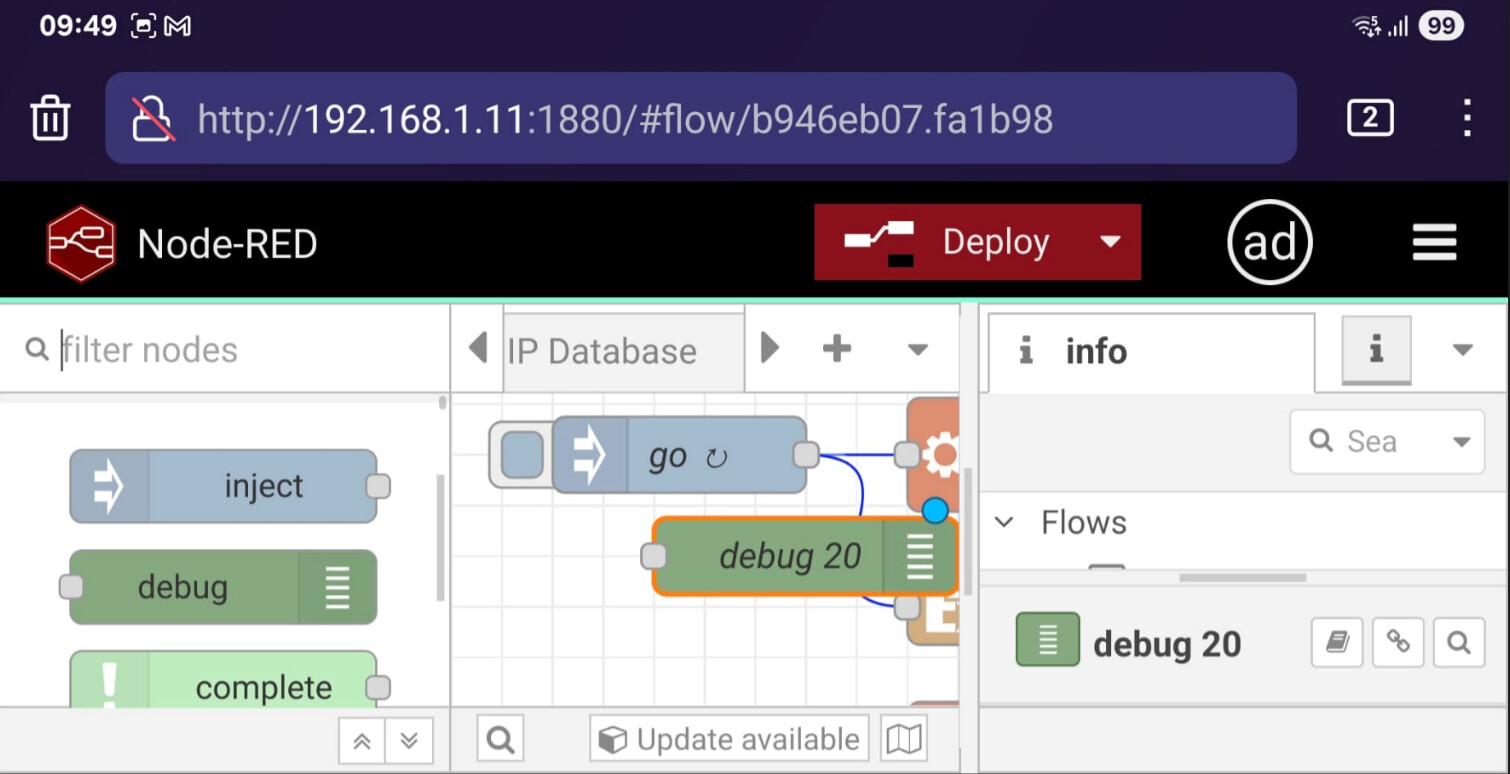

Consider Node-red on a mobile phone (already unusable)
Vertical tabs would occlude even more of the desktop.
Now, if the palette and right hand sidebar could collapse into dropdowns alongside the hamburger menu, by all means put vertical tabs in a dropdown there too.
