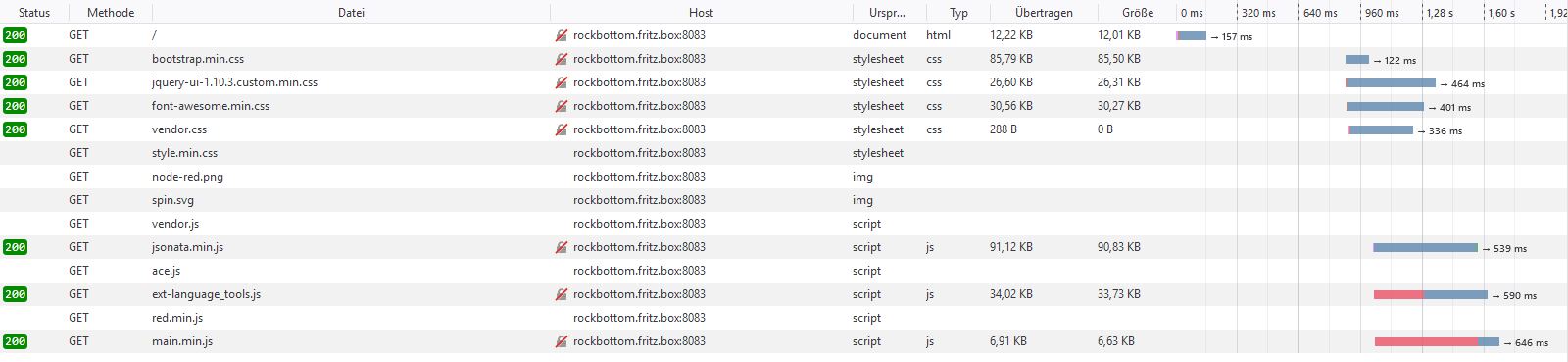

However, I have a problem calling the Web UI. The UI loads only partially. The missing data is not transmitted to the browser. I tried different node red versions and browsers. It's always the same:
