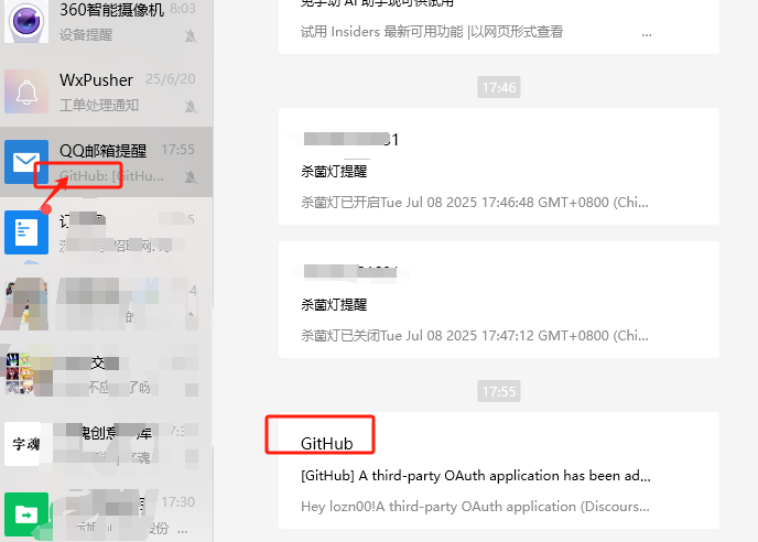

Nodered need support email custom From(Nickname)

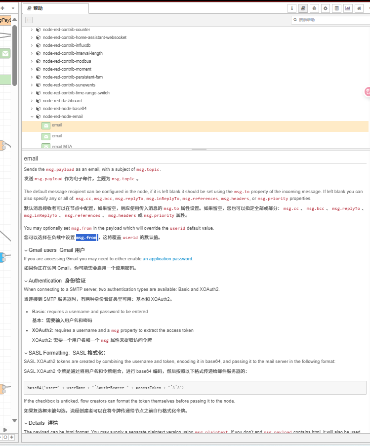

The node help sidebar explains you can use msg.from to set this field.
thank you
send fail
if add msg.from will send failture
the msg.from only support email address, not nickname,

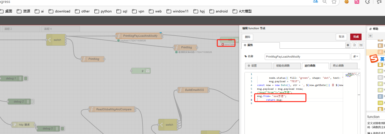

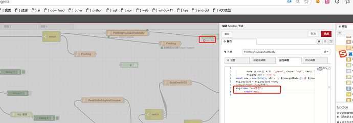

i am sorry , the code is ok:
msg.from= '"X" x@lozn.top'
