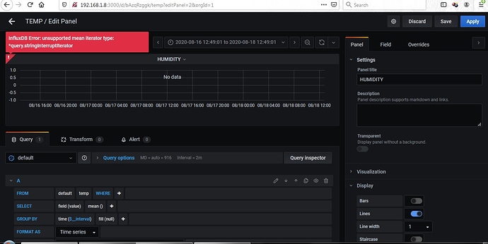

Yes, they was second queries, but i was forget about it (sorry).I delete it, but the problem remains (but a little different).
This is the new query inspector:
  "request": {
    "method": "GET",
    "url": "api/datasources/proxy/1/query",
    "params": {
      "db": "HUMIDITY",
      "q": "SELECT mean(\"value\") FROM \"temp\" WHERE time >= 1597571341360ms and time <= 1597744141368ms GROUP BY time(2m) fill(null)",
      "epoch": "ms"
    "data": null,
    "precision": "ms"
  "response": {
    "results": [
        "statement_id": 0,
        "error": "unsupported mean iterator type: *query.stringInterruptIterator"
    "executedQueryString": "SELECT mean(\"value\") FROM \"temp\" WHERE time >= 1597571341360ms and time <= 1597744141368ms GROUP BY time(2m) fill(null)"
Have you written strings to the value field instead of numbers? If you want to chart them then they must be numbers.
Like This?
No, where you write to the database (in node red presumably). I suspect that you have written strings instead of numbers.
Actually it did do the trick, now i don't have errors, but still can't collect data.
Make sure you zoom out in case the data is outside the time range.
