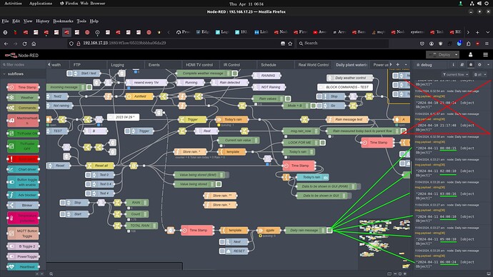

This is what I am seeing - kind of again - and note how the 01:00 message is missing.
Yes, there is a slight problem with how I am seeing the messages in that the objects aren't expanded and therefore readable.
But that the error happened at 01:00 and the 01:00 message is missing I'd say there is some relationship there.

See new screenshot at the top all the crossed out stuff.
That was me testing it last night.

Screenshots with hundreds of nodes and debug messages with next to no info are not great for diagnosing issues.
As mentioned above, set the a http node with the request to out put a utf8 string and set a debug to output complete message object. Then capture a good return and a bad return (invalid json). We can then compare the returns and offer fixes.
