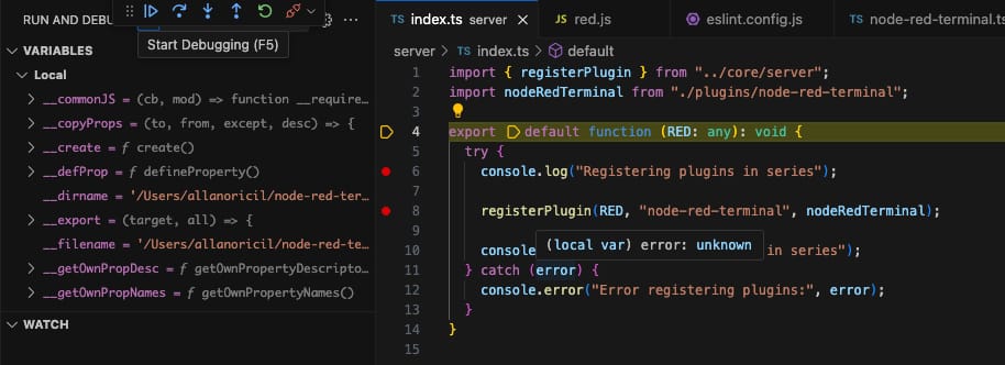

What am I during wrong? Even when opening the editor I dont see the plugin's server entrypoint tunction being executed.

<img width="701" height="407" alt="Image" src="https://github.com/user-attachments/assets/a6e0965a-6a12-4229-a2eb-f9fad8844bae" />

I'm a bit confused as to how you are trying to do things. You still need an entry in the package.json don't you? In order to tell Node-RED that the plugin needs to be processed?
There is. The files are required by node-red. But the entrypoint is called.
This is the entrypoint being required by node-red
Here is the initial plugin being loaded without a problem
AllanOricil:
There is
I must be missing something:
Don't you need a node-red section?
Look at the dist. You must build it, and install the build
OK, dist isn't in the github repo so I can't see it.
Normally though, the package.json that node-red will acknowledge is in the root of the package, not in a folder. Could that be the issue?
I installed the dist folder.
OK, I don't think I can help without running your build which I can't do right now.
