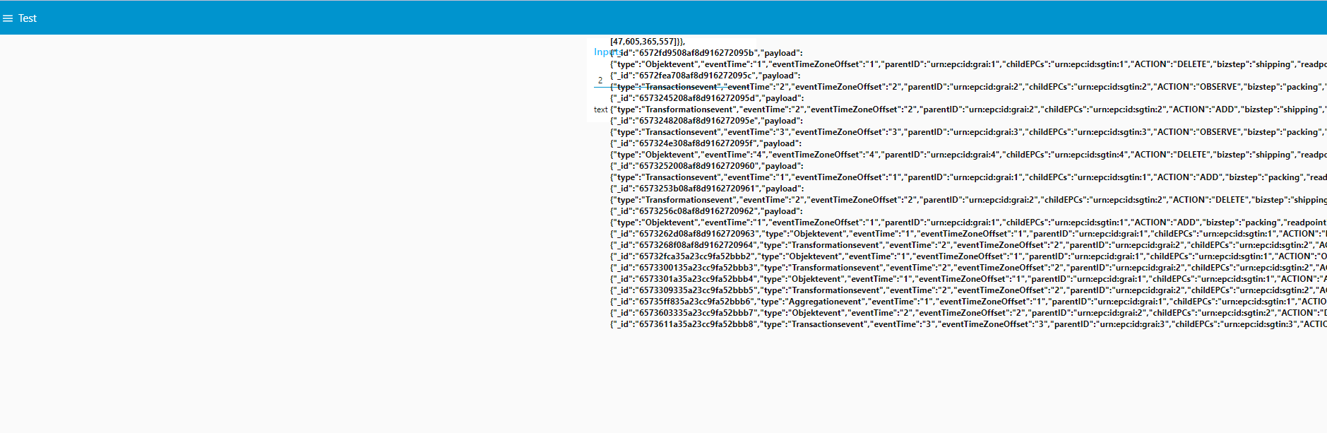

Hi Colin, here is an excerpt of the data from my MongoDB. In the previous step, various data is bundled together and transferred to MongoDB.
Now I would like to add a field to the dashboard in Node Red in which I enter for example the parentID number: urn:epc:id:grai:2 and node red then calls up exactly this entry from the database, with all the associated payload as shown in Figure 1
Unfortunately, it currently looks like this for me: (All entries in the Mongo Db are simply returned)
So I think i would have to specify in a node what exactly it should search for or retrieve... I hope you understand my problem....

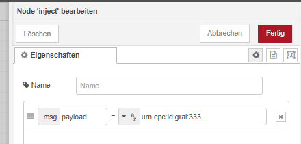

(In the picture now only using a inject node to create msg.payload with the value of "urn:epc:id:grai:333")

I have temporarily replaced the text input field with an inject node, which generates an msg.payload with a query value as an example. (later the msg.payload should, in the best case, be able to be entered variably in the dashboard)
This is followed by the function:
With the current settings, I no longer get any values back:
