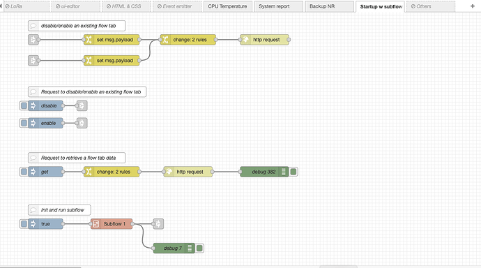

Here is a sample flow demonstrating the use of the Admin API
In the first tab, you have various functionality available like disable/enable tabs and request complete data of a tab
I also added a subflow to demonstrate how the finished execution of it could trigger the enabling of the other tab(s)
My example has only one tab that gets enabled but this could of course be extended, you get the idea

Yeah, I would do it per tab. Here is a more developed flow that gets the actual tab data including nodes etc and changes the “disabled” property in the object. I would make one for each tab and then you can edit the tab as you like. Only thing you need to provide is the tab id. Next time it will use the tab as it is currently defined
