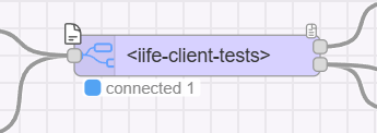

Based on your messages, there's a need to separate static statuses from ephemeral statuses.
I'll try to define them with an example:
static: connection status with the broker, database, etc.
ephemeral: related to message processing
If we separate them, we can consider that ephemeral statuses are purely debugging (visually see the process) and therefore do not trigger a change in the status node. This ephemeral status will restore the initial status at the end of duration.
An ephemeral status is a purely virtual; the runtime will only send the status to the editor if at least one editor is open. A user must therefore have their editor open to trigger these ephemeral statuses.
These statuses are not saved/retained; closing and reopening the editor will not cause the previously present ephemeral status to appear.
As its name suggests, the status has a limited lifespan. Once the duration defined or by default is expired, the status will clear or display the last static status if there.

5 Seconds? Or what is the default for the notification display? Set it the same as that?
To be honest, you don't really need the ephemeral flag do you? Just use the duration. If it is set to a number, the status is ephemeral. Otherwise, it is not.
2 or 3 seconds. Steve's gif gives enough time to read the ephemeral staus and it should not hold up the progress of the node
Keep the current status as is. If it were to be cleared, for example the 'connected' status of an MQTT node, would disappear
Current status handling as is. Why would a list of ephemeral statuses be required. Most would revert to current status. If a 2nd ephemeral status is required to revert to a previous ephemeral status reissue or update to previous.
I also like the way Steve displayed the ephemeral status in italics so it can be distinguished from the current status
