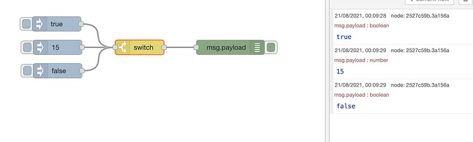

Switch between numeric values passes when value is true/false
Is this working as designed ? Should true/false pass ?
Neither true or false are numbers, thus probably passes through as extraneous data?
EDIT Actually, it is accounting for the binary "value" of the Boolean, AKA 1 or 0, as confirmed by changing the switch values from 0-255 to 1-255, thus preventing false to pass
Yes that seems to happen here.
I have added an additional switch to make sure that the type matches numeric. I just wonder if this should be handled directly in the case of the "is between".
I suspect it is the way it is meant to be, as there are surely many valid reasons for a boolean to be treated by it's numerical value. But if not desired to be treated equally then can easily be overcome with a preceding switch using the is of type = number filter (~as you have probably done~ EDIT as I reread and see that is exactly as you have done :blush: ).
You could handle the bug using a JSONata expression and only use one switch node.
$type($$.payload) = "number" ? 	($$.payload >= 0 and $$.payload <= 255) : false
