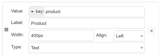

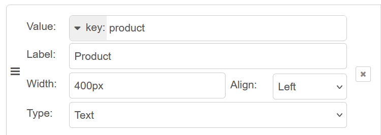

Using the ui-table widget I can influence the width of a column by putting a value in the widget's column setup:
(Oddly, this seems to make this field 339px wide, not 400px)
