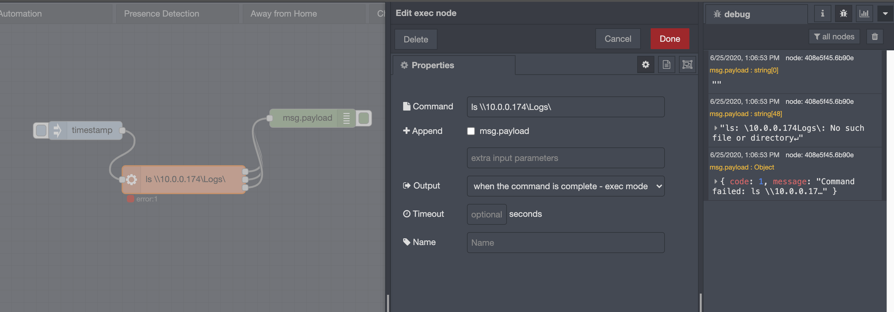

Im getting this am i doing something wrong?
As expected, the error is "No such file or directory". There is no path from the server running Node-RED to that shared folder. Most likely the virtual user running Node-RED inside Docker has no permissions to access that shared drive.
You may need to dust off your SAMBA command-line fu to try and connect to it.
