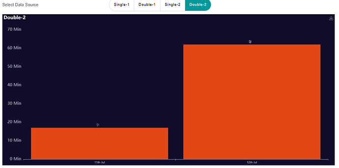

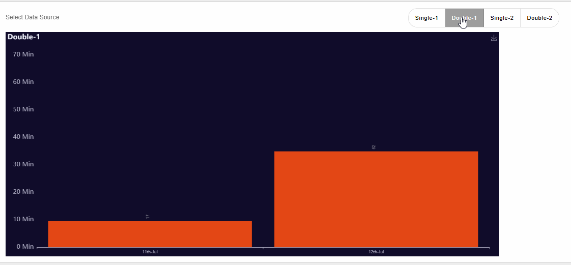

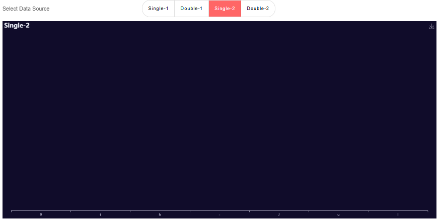

I am having issues in getting the data to plot when the number of elements in an array is single.
if i change the way i prepare the data with jsonata, i am able to get the single element to plot, but then multiple element array fails to plot.
what am i doing wrong ?

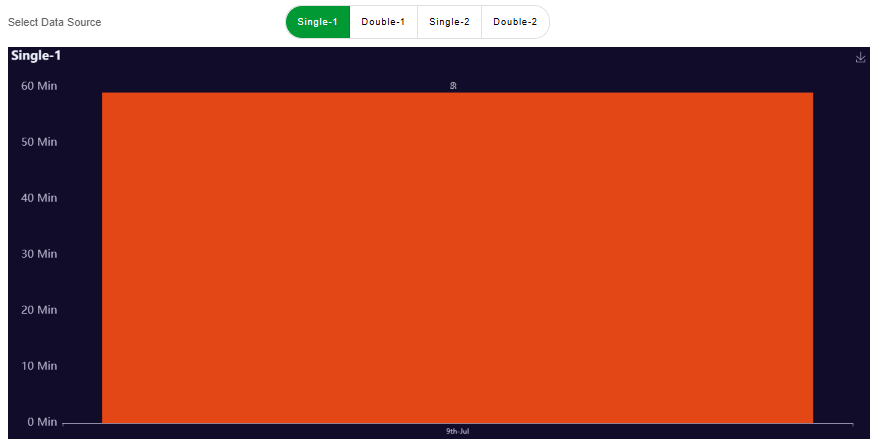

This works for single element in an array with
$$.pload.rdate.[$]
but then with same option, a multiple element array does not work. i get only labels, but not values
if I cahnge the jsonata to
$$.pload.rdate
then multiple element array is plotted, but single doesn't
I can not see the charts , not sure why, so hard to tell for sure.
Can you supply the output to template that works for both scenarios.
Saying that to force a singleton to an array in JSONata use
[$$.pload.rdate]
Or
$$.pload.rdate[]
Neither will affect an array output Query refinement using predicate expressions · JSONata
this worked.
