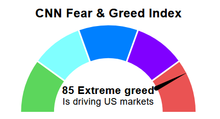

Ui-gauge prefix, value & suffix
This gauge roughly imitates CNN's business page Fear & Greed Index
In this instance, msg.payload = 85 and msg.ui_update.suffix = "Extreme greed"
The HTML for this line is <span>85 Extreme greed</span>
If the prefix, value and suffix were seperate items
<span class="prefix"></span><span class="value">85</span><span class="suffix"> Extreme greed</span>
then they could be individually styled, eg
.nrdb-ui-gauge-value span.value {
display: none;
That seems reasonable to me.
