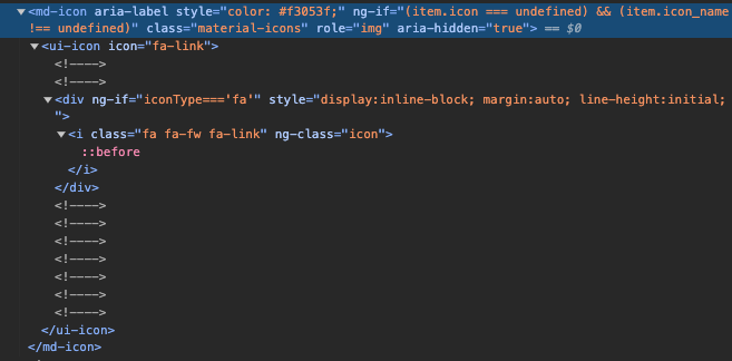

What element is the icon displayed as?
Use your browser tools to inspect the icon to find out.
I don't know and I'm away from my computer but I wouldn't be surprised if the style you need includes."fill"
if I set the value of md-icon aria-label style="color: #red;" to red it makes what i want:
Bildschirmfoto 2023-12-17 um 20.52.51
but putting that in to the icon_name field does just write it to the line as text.
Bildschirmfoto 2023-12-17 um 20.59.28
You need to use a ui-template to apply CSS styling to the icon. It can be on your editor tab but doesn't need to be wired into the flow.

Hmm. It has included "style color = ..." as part of the list of classes.
You could make use of that:
        "title": "No WiFi Signal",
        "description": "Lost network connection",
        "icon_name": "fa-window-close makeitred"
Now you have a class "makeitred" to style
