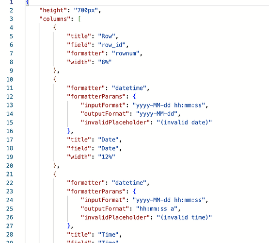

OK, here's an example. In ui-tabulator, let's assume you have a column "age", and you want red background color for every row in which age<18.
  1. In the table configuration, add a row formatter, which will dynamically set the row background color to red if age<18. The formatter will be called ageColor, and will be prefixed by @F: to indicate that it is a function.
   "height": 300,
   "columns": [...],
   "data": [...],
   "rowFormatter":"@F:ageColor"
  1. Now define the actual function body in the Custom Functions area:
function ageColor (row)
    if (row.getData().age < 18)
       row.getElement().style.backgroundColor = "red";
That's it. Just change it to your required logic.
