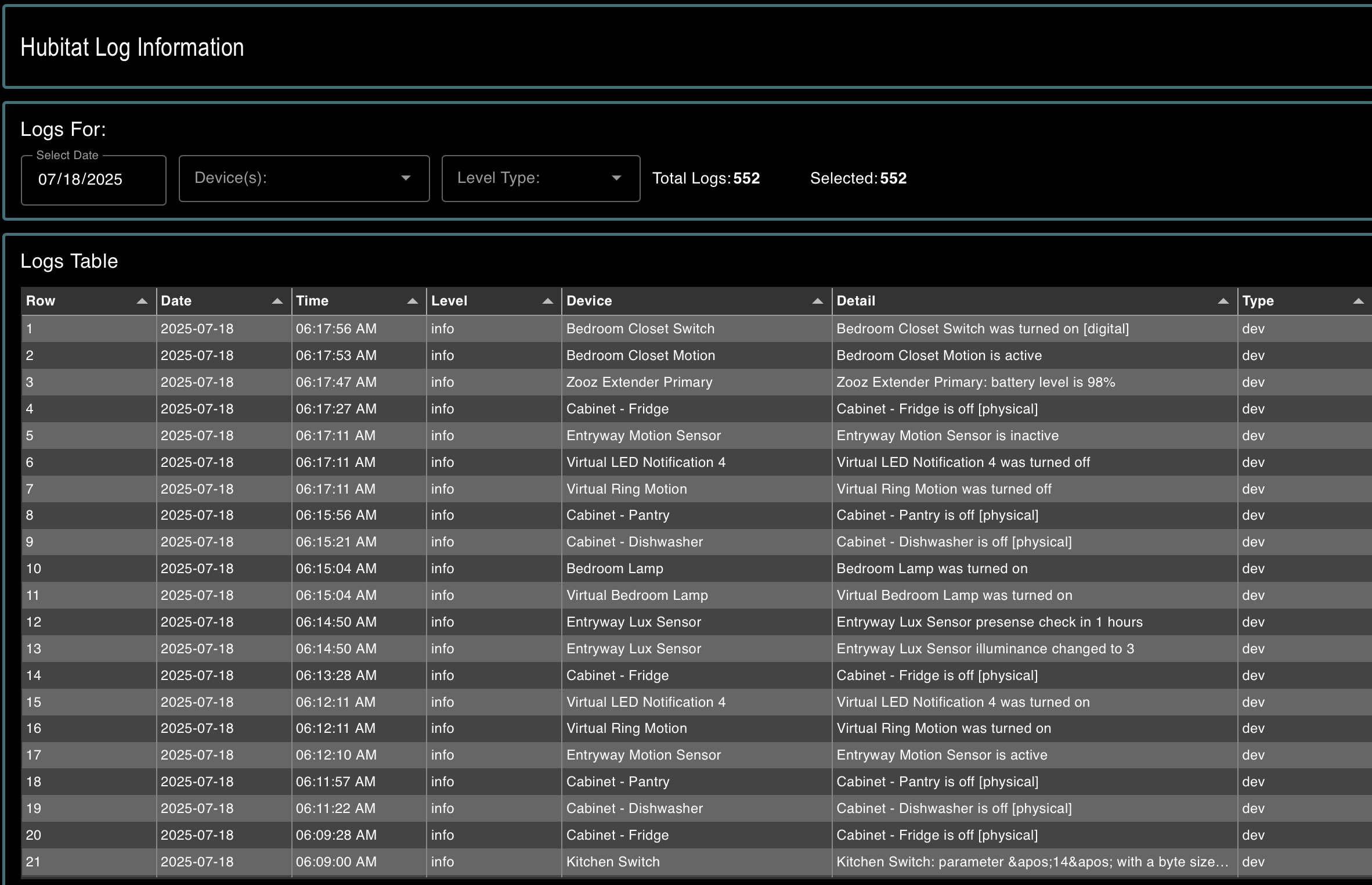

Page 1 (Working):
Page 2 (Not Working):
Below is the flow with sample data. Can you take a look? Not sure if I have missed something (quite likely) or there is an issue with ui-tablulator. Thanks for your help

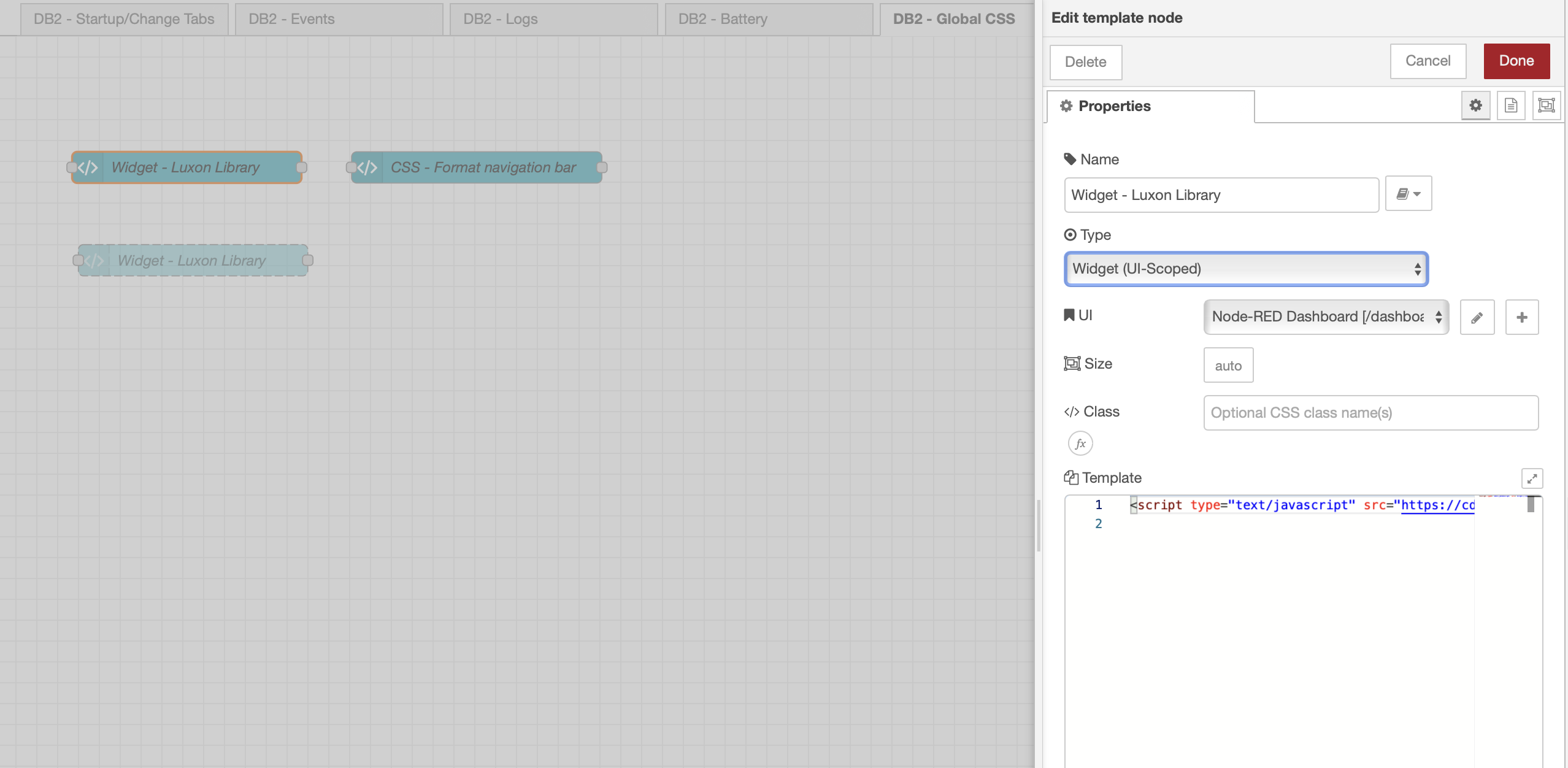

How is the template which imports the luxon scoped?
To serve all pages it needs to be scoped to the whole dashboard (scope=UI), or have a copy of it on every page.

I had it scoped as UI, I also tried it with page and group but it made no difference.

ui-template config:

You can also remove the luxon loader, as it is now implicitly loaded within the node
