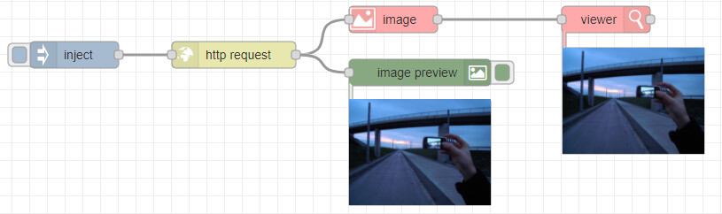

Im trying to show a file:// but can't get it to work.
If I add this link to my browser app, I see an image
"file://mynas/docker/frigate/media/clips/foran-1620191711.030997-b2cpcd.jpg"
But if using this flow I can't get the image to show. (My docker folder is added to a SMB with username and password)
But if I then changes it to use a http from then net, it works
How can I show the file:// or show the file from my SMB share?
Say if you need some info :slight_smile:
If you have a mount point in your docker, then try using a normal file path (drop the file://)
Also, as a basic test, you could use an intect -> file in node -> debug node, to verify the file can be accessed.

I do have a mount point in my Node-Red docker to my FriGate docker, and I get the image name, but no visual image is showed..
Did you set the file node to return a buffer?

Thx. yes now I have added the "Single buffer object".
Will this mean that I in a "telegram" sender node can add the path to a function like:
var payload = {
    chatId: xxxxxxxxx,
    type: "photo",
    content: "/frigate/foran-1620191711.030997-b2cpcd.jpg" };
return {payload};
UPDATE!!
Yes it will.
