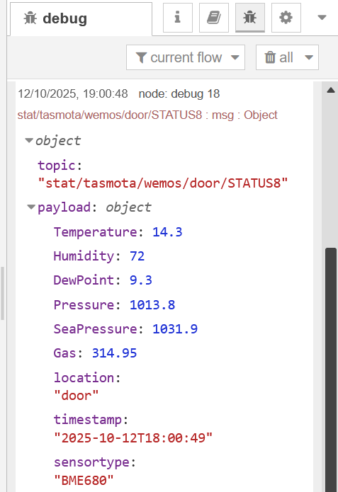

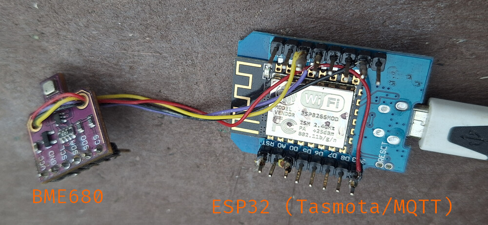

For what it's worth, this is how I interface between Node-red and my BME680:
