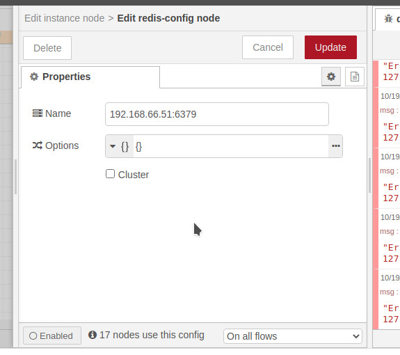

I deployed nodered via docker/dockerhub
As shown in the attachment, I'm hosting my redis on a seperate server within the same subnet as my nodered.
I changed the redis instance information to point to the IP of the server, however the debug logs point to nodered connecting to localhost instead of the 192.168.66.51
Can somebody please advise?
If you click on the pen next to the server field what does it show?
Yes, using the pen button was how I initially added my external redis instance
Here is the screenshot:

solution
Connection Options parameter receives IORedis object or string (https://github.com/luin/ioredis#connect-to-redis).
