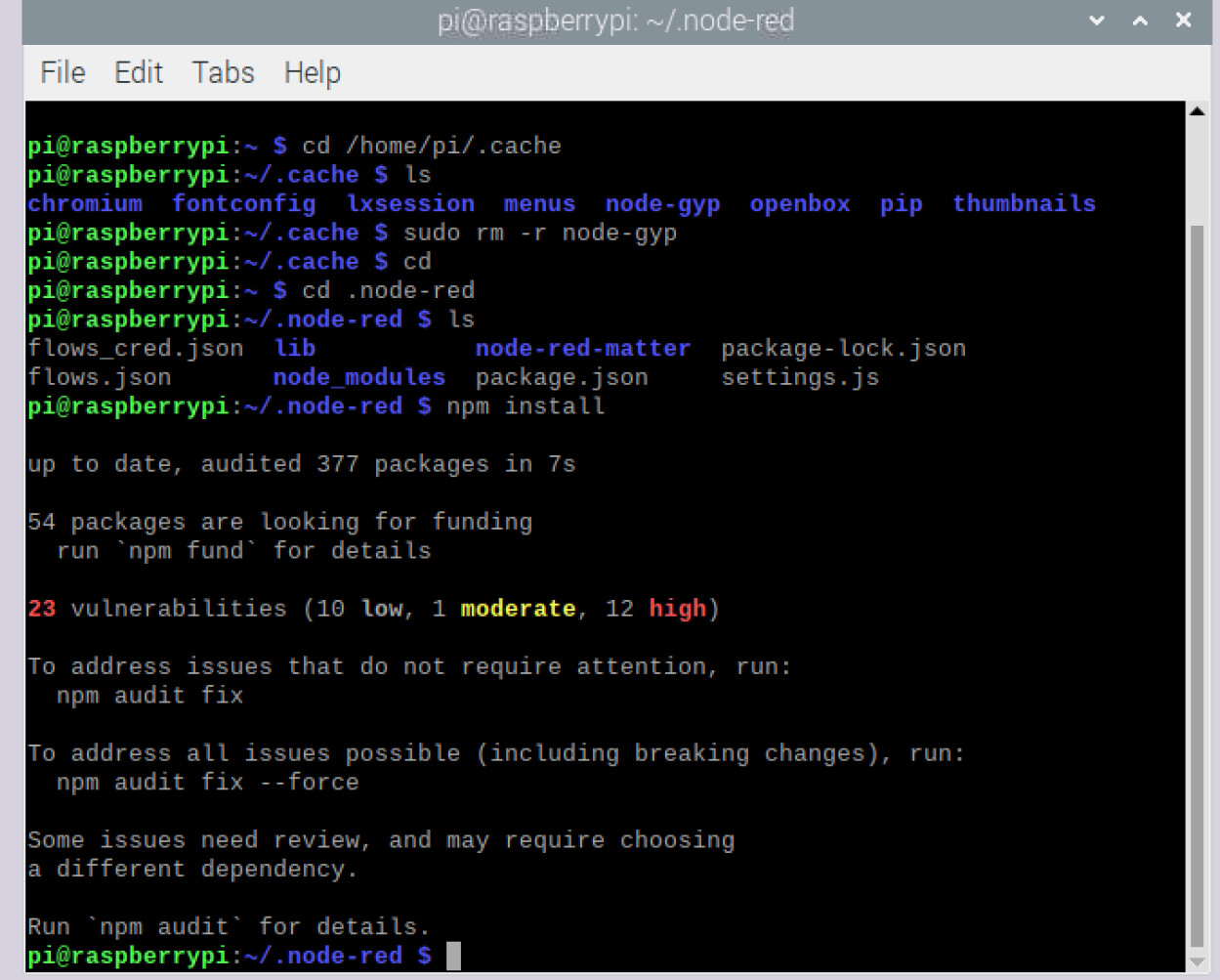

I wonder whether your node-gyp cache is corrupted. Delete the folder /home/pi/.cache/node-gyp and run npm install again (from the .node-red folder as before).
did that and got
That does not make sense, last time you said that after removing the node_modules folder:
But now it says that it was all up to date., which suggests there were no errors last time.
Can you do that again please, remove the node_modules folder and run
npm install
and make sure there are no errors shown in the command window
If that is ok then try
npm install node-red-contrib-onvif
and see if that gives errors in the command window.

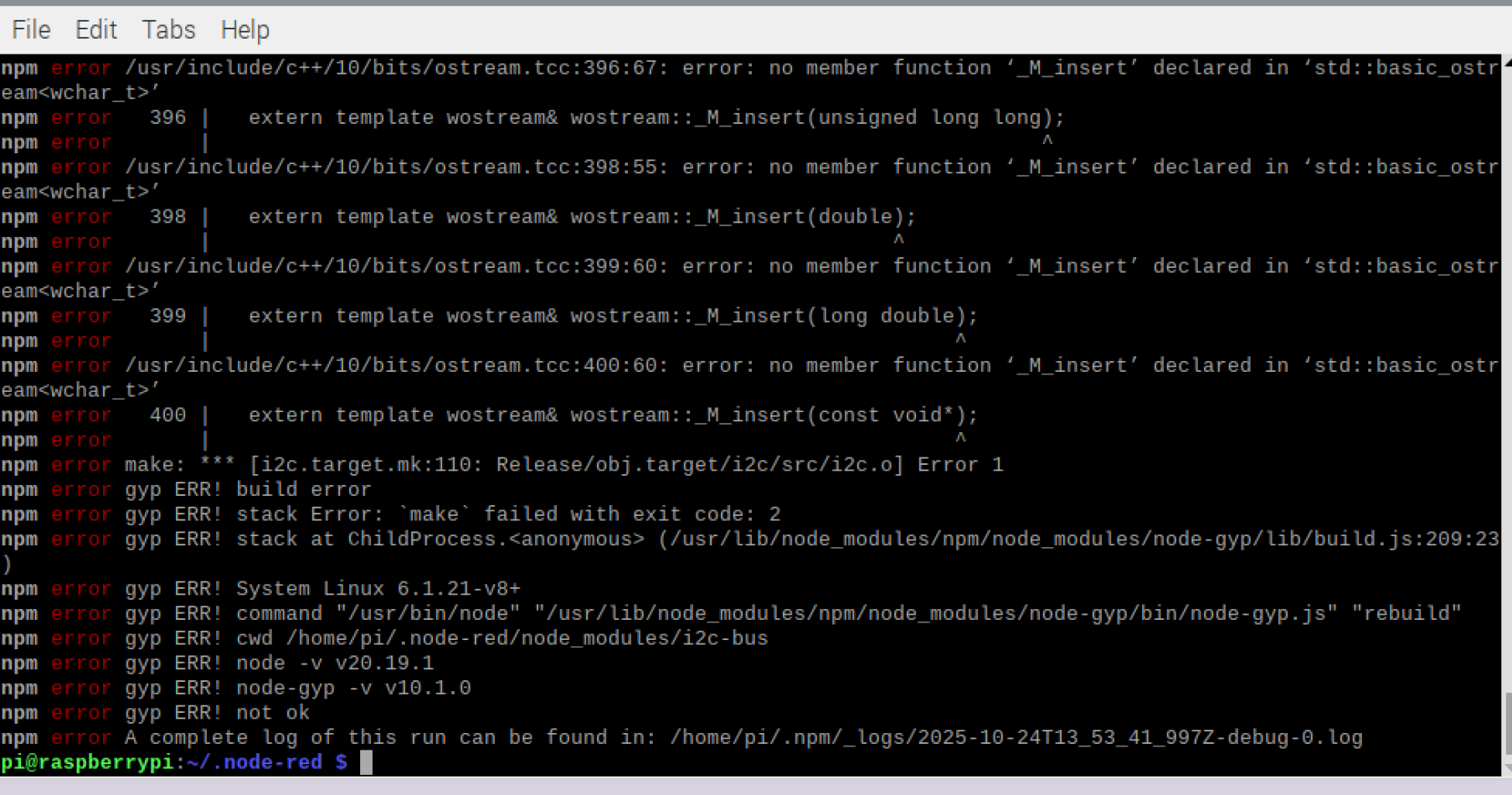

tried installing onvif it failed again, so giving up with onvif lol not worth my sanity .

Odd, it installs for me on a very similar system. I suspect there is something wrong with your system which will bite you at some point. Does the serial node install ok? node-red-node-serialport? If not then there is something wrong with your build tools, but I have no idea what.
You might like to try this onvif package, which works well for me and is used by others here GitHub - bartbutenaers/node-red-contrib-onvif-nodes: Node Red nodes for communicating with OnVif compliant IP devices
It hasn't been published to npm so you have to install from the command line (in your .node-red folder), using the command in the link I posted.
