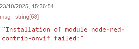

hi I cant install the node-red-contrib-onvif node,
it just comes up with
and (npm warn config production Use `--omit=dev` instead.
npm warn deprecated npmlog@4.1.2: This package is no longer supported.
npm warn deprecated are-we-there-yet@1.1.7: This package is no longer supported.
npm warn deprecated gauge@2.7.4: This package is no longer supported.
npm error code 1
npm error path /home/pi/.node-red/node_modules/sharp
npm error command failed
npm error command sh -c (node install/libvips && node install/dll-copy && prebuild-install) || (node install/can-compile && node-gyp rebuild && node install/dll-copy)
npm error sharp: Using cached /home/pi/.npm/_libvips/libvips-8.10.6-linux-armv7.tar.br
npm error
npm error make: Entering directory '/home/pi/.node-red/node_modules/sharp/build'
npm error   TOUCH Release/obj.target/libvips-cpp.stamp
npm error   CC(target) Release/obj.target/nothing/node_modules/node-addon-api/nothing.o
npm error rm -f Release/obj.target/node_modules/node-addon-api/nothing.a Release/obj.target/node_modules/node-addon-api/nothing.a.ar-file-list...)
any help would be much apreciated.
thanks
martin
