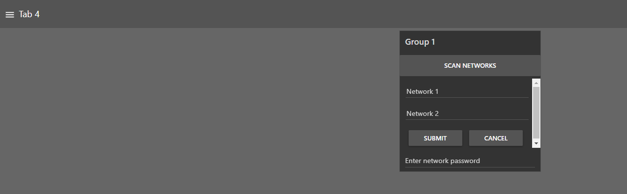

I'm going to build a few of the machines as a off the shelf product and the client needs to be able to connect the pi to their network which will be unknow to me so I need to find a way they can do this without any coding or even leaving the dashboard.
Ideally from the dashboard the client needs to scan the SSID and view available networks then select one and enter the password.
Could you edit the wpa-supplicant file without leaving the node red UI or using the terminal?

Assuming it is the wifi of the node-red server machine (which may not be the same machine that is running the browser) then If you give the user running node red permission to write to the file then you can do it using any of the file access nodes.
For scanning, if there aren't any nodes already in the node red flows library, then you can use an exec node running an appropriate command to do the scan.
You could but it shouldn't be necessary. I think that I would engineer in a "First Run Experience" that lets the customer select the appropriate network on first use (and end the passcode of course) but that then doesn't appear again unless the device is reset. This could be as simple as a dedicated terminal script that lists the networks in sight, allows selection and entry of the passcode.
