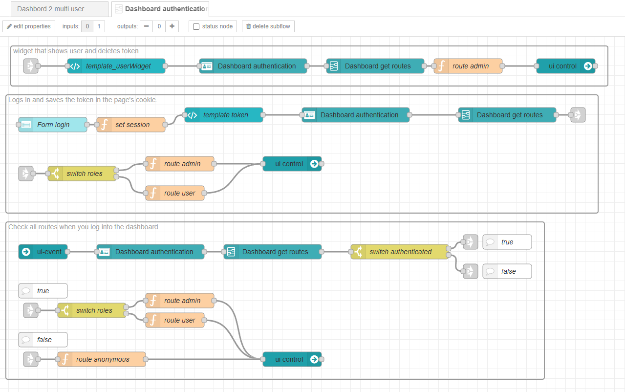

Dashboard 2: Multi-User Framework with Role Permissions and Route Authentication
Recently, I created a model that appears to be easy to implement and does not rely on external plugins to enable Multi-User support with Permissions in Dashboard 2. It uses the Client Data feature along with a template that injects a token via cookie into each dashboard section.
If anyone has suggestions for improvements, please feel free to comment.
This model provides:
  • Multi-user support with permission control;
  • Route-level authentication;
  • Authentication for simple actions, such as button clicks.
Example flow with authentication message:

Dashboard 2 can be configured to be Multi-Tenant with the Client Data feature, where each client on the dashboard has a unique socketId. This allows information to be sent exclusively to the specific socketId of each client.
In my framework, I implemented the addition of a token via cookie, which allows the user to validate when a client enters a specific page on the dashboard. This is done through the UI-Event, which retrieves the user's token and performs the validation on Node-RED. Based on this validation, the system decides whether or not to display the data on the front-end, similar to how data is sent to Node-RED.
It's important to note that the user would need to program all route and action validations within the system.

Very well noted regarding the security concerns, especially the need to continuously verify whether the client is still authenticated before sending data to Node-RED.
In the code example, the user must validate all actions sent to Node-RED.
The token used is a UUID with a 7-day validity period. No validation is performed on the client side; all validation happens in Node-RED, where sessions are stored and checked. After the session is validated, a new object msg._dashboardSession is added containing the session information.
The flow still needs several improvements, but it already serves as a good starting point for implementing multi-user security in Dashboard 2 without relying on external libraries.
This code was designed for use in a private network, mainly as an HMI in an industrial environment, which is my primary use case with Node-RED.
For internet-facing use, there are certainly several additional points that would need to be reviewed. Thanks for the insights!
