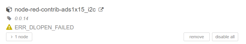

When I download it using the Node-Red GUI and the palette manager the node fails to deploy and give an error. The node only says “ERR_DLOPEN_FAILED“ next to it.

[node-red-contrib-ads1x15_i2c/ads1x15_i2c] Error: Module did not self-register: '\?\C:\Users\berky\.node-red\node_modules\i2c-bus\build\Release\i2c.node
and the nodes aren’t available to use, giving the same ERR_DLOPEN_FAILED warning.
