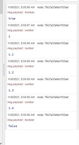

went out to website for knobs and made a new png file got this
maybe
so I'm getting closer, and as an added bonus I even get output
You are getting an output now as it should... Windoze/the forum is messing it up in the save I think....
