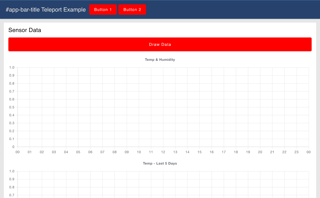

How to add buttons or text elements to the topbar of dashboard 1?
I found the following example in the official documentation of Dashboard 2, which can be applied to Dashboard 2 but not to Dashboard 1.
<template>
    <Teleport v-if="mounted" to="#app-bar-title">
        <v-btn>Button 1</v-btn>
        <v-btn>Button 2</v-btn>
    </Teleport>
</template>
<script>
    export default {
        data() {
            return {
                mounted: false
        mounted() {
            this.mounted = true
</script>
I would like to ask how to modify the above code to make it effective in Dashboard 1?
