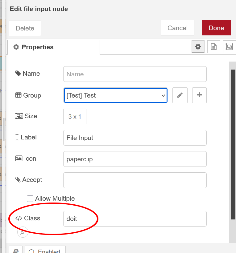

You can change the button label with javascript, but if like me you are averse to javascript in dashboard widgets, there is a work-around using CSS.
- Give your File upload node a custom class 'doit'.
- Add a CSS type template. It's scope can be single page or all pages. The template content should be

Thank you for your detailed guidance. This can be used on my device.
