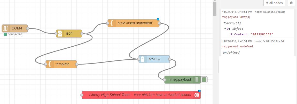

Upper Template Node is storing attendance record to MSSQL
Lower Template Node is getting parent's phone number from MSSQL by using SELECT statement I have mentioned above.
I'm using Debug Node to make sure that I can actually get the phone number from MSSQL, You can just ignore the second result (Undefined).
For now, I would like to use the phone number I get from MSSQL, and send SMS using Twilio Node. But Twilio Node can only put a To phone number in node properties, that means only one parent can get the SMS. All SMS will be received by only one phone number (parent), even not his/her children

Is it correct? Change Node properties
And I always get the error Connection is closed to MSSQL Node. I don't know why
